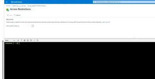

You can use the below cmdlet to enable the public network access to the azure webpp.
az resource update --resource-group <resourceGroupName> --name <WebappName> --resource-type "Microsoft.Web/sites" --set properties.publicNetworkAccess=Enabled
I have tested this out in cloud shell, it is working fine.
Here is the sample output for your reference:
