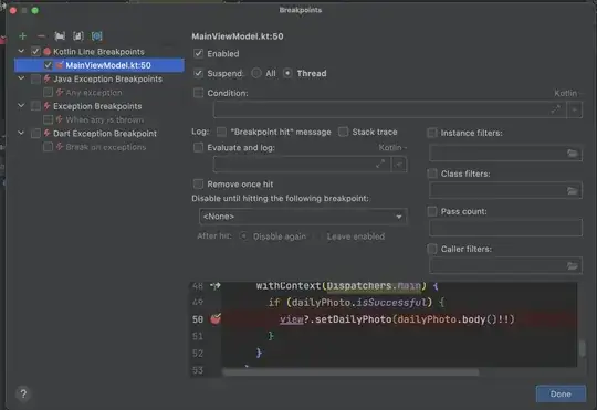

I had tried to change the suspend breakpoints setting from all to Thread and the debugger was worked normally. You can make that setting to default so that you don't need to switch for every breakpoints. Here is the screenshot of the settings:
