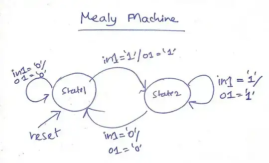

I am fairly new to VHDL and am following this tutorial to implement the following Mealy Finite State Machine:
and have written the following code in VHDL:

As you can see the output o_mealy changes even without clock edge. It simply seems to only be following the input. By contrast, I have implemented the equivalent Moore machine and it seems to be working just fine:
If anyone can point out what I am doing wrong, it would be highly appreciated. Again, I have used this video for reference. I am using GHDL with GTKWave.
