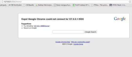

And when I make a request to the /save endpoint I get the following issue
