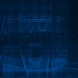

tl;dr: when I calculate and visualize an FFT for any audio sample, the visualization is full of background noise to the point of swallowing the signal. Why?
Full question/details: I'm (long-term) attempting to make an audio fingerprinter following the blog post here. The code given is incomplete and this is my first time doing this kind of audio processing, so I'm filling in blanks in both the code and my knowledge as I go.

The post's visualization results as shown are good quality. This is a picture of a sample from Aphex Twin's song "Equation", which has an image of the artist's face encoded into it:
Indeed, when I take a short sample from the song (starting around 5:25) and run it through the online spectrum analyzer here for a sanity check, I get a pretty legible rendition of the face:
But my own results on the exact same audio file are a lot noisier, to the point that I have to mess with the spectrum analyzer's colors just to get something to show at all, and I never get to see the full face:
I get this kind of heavy background noise with any audio sample I try, across a variety of factors - MP3 or WAV, mono or stereo, short sample or long sample, a simple audio pattern or a complex song.
I've experimented with different FFT window sizes, conversion from raw FFT frequency output to power or dB, and different ways of visualizing the FFT output just in case the issue is with the visualization. None of that has helped.
I looked up the WebAudio implementation behind the Academo online spectrum analyzer, and it looks like there's a lot going on there: a Blackman window instead of my simple rectangular window to smooth the audio sampling; an interesting FFT with a built-in multiplication by 1/N, which seems to match the Unitary normalization provided by Apache Commons' FFT class; a smoothing function on the frequency data; and conversion from frequency values to dB to top it all off. Just for fun, I tried mimicking the WebAudio setup, but with about the same or even worse noise in the results, which suggests the issue is in the FFT step rather than any of the pre or post processing. I'm not sure how this can be the case when the FFT passes my basic calculation checks. I suppose the issue could be in the audio reading step, that I'm passing garbage into the FFT and getting garbage back, but I've experimented with reading the audio file and immediately writing a copy back to disk, and the new copy sounds just fine.
Here's a simplified version of my code that demonstrates the issue:

* https://stackoverflow.com/questions/8887896/why-does-my-kiss-fft-plot-show-duplicate-peaks-mirrored-on-the-y-axis/10744384#10744384 ), which produces a mirror of its own inside
* the positive elements. We need to further divide the positive elements in half. This leaves us with the first N/4 elements after all is said and done.
while (fftIndex < currentChunkFftResults.length / 4) {
Complex currentChunkFftResult = currentChunkFftResults[fftIndex];
// To get the magnitude of the sound at a given frequency slice
// get the abs() from the complex number.
// In this case I use Math.log to get a more managable number (used for color)
double magnitude = Math.log10(currentChunkFftResult.abs() + 1);
// The more blue in the color the more intensity for a given frequency point:
/*int red = 0;
int green = (int) magnitude * 10;
int blue = (int) magnitude * 20;
graphics.setColor(new Color(red, green, blue));*/
float hue = (float)(magnitude / 255 * 100);
int colorValue = Color.HSBtoRGB(hue, 100, 50);
graphics.setColor(new Color(colorValue));
// Fill:
graphics.fillRect(timeIndex * blockSizeX, (windowHeight - yIndex) * blockSizeY, blockSizeX, blockSizeY);
// I used an improvised logarithmic scale and normal scale:
int normalScaleFrequencyDelta = 1;
int logScaleFrequencyDelta = (int)(Math.log10(yIndex) * Math.log10(yIndex));
if (logScaleFrequencyDelta < 1) {
logScaleFrequencyDelta = 1;
if (useLogScale) {
fftIndex = fftIndex + logScaleFrequencyDelta;
else {
fftIndex = fftIndex + normalScaleFrequencyDelta;
yIndex = yIndex + 1;
private int calculatePixelHeight(Complex[] fftResults) {
int fftIndex = 1;
int tempPixelCount = 1;
int pixelCount = 1;
while (fftIndex < fftResults.length / 4) {
pixelCount = tempPixelCount;
int logScaleFrequencyDelta = (int)(Math.log10(tempPixelCount) * Math.log10(tempPixelCount));
if (useLogScale) {
else {
tempPixelCount = tempPixelCount + 1;
return pixelCount;
