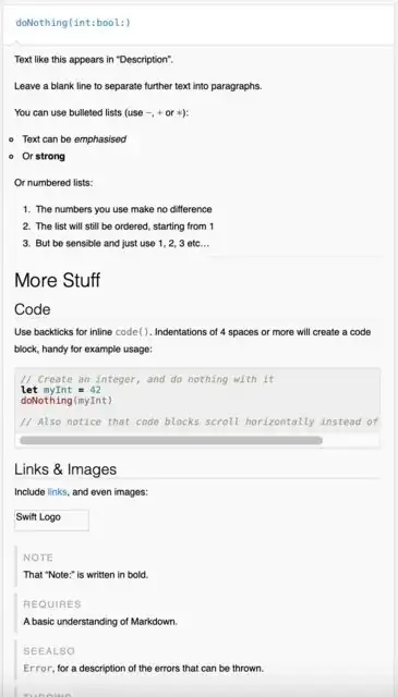

On the other hand, if I use a documentation generator like jazzy like the linked answer suggests, the headings and all the other text are rendered properly:
There is no Swift Logo because I didn't download one to my local machine :) Your documentation for formattedString function is also generated properly by jazzy, without needing to change anything.
