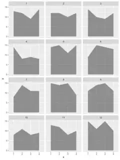

This yields (converted to a bitmap so I could upload it):
No issues with R or ggplot2 at this point. Imported into WORD, and everything looks great.
