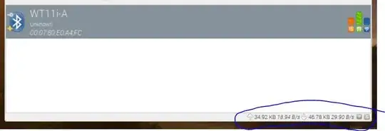

The device is connected:
When pairing the pwd from the sending device was requested.

Bluetoothctl output as code:
WT11i-A]# info
Device 00:07:80:E0:A4:FC (public)
Alias: WT11i-A
Class: 0x00001f00
Paired: yes
Trusted: yes
Blocked: no
Connected: yes
LegacyPairing: no
UUID: Serial Port (00001101-0000-1000-8000-00805f9b34fb)
UUID: PnP Information (00001200-0000-1000-8000-00805f9b34fb)
Modalias: bluetooth:v0047pF000d0400
