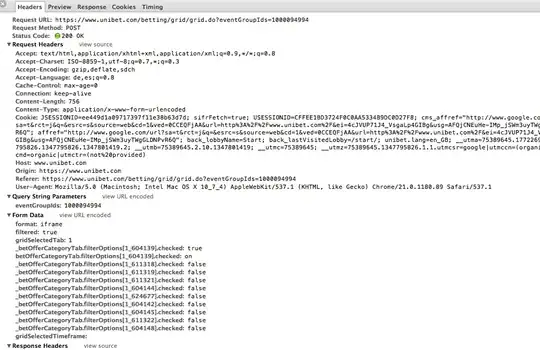

Here's a screenshot that may make more sense:
Notice that all of the output points to my module definition and not the currently executed script.
