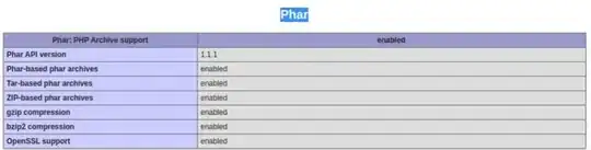

So I tried to see if the phar extension is activated, and it seems to be :
The only odd thing I found is the location of the php.ini, in phpinfo() it tells me the path is :
But I get this result with php --ini :
