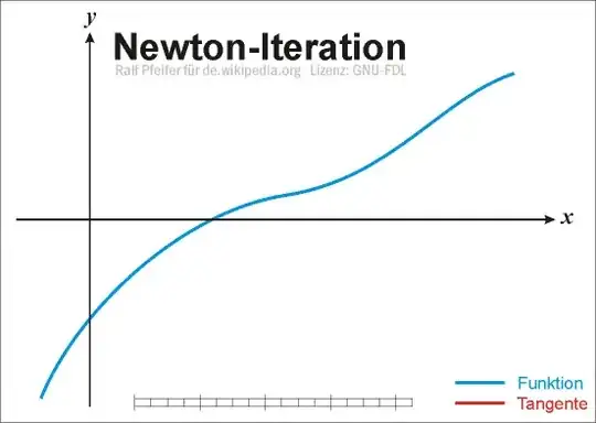

The lambert function is the reciprocal function of g(w) = w*exp(w) it verifies:
W(z)eW(z) = z.
A good way to evaluate W(z) on a given z would be to use newton raphson method :
to solve : f(Y)= Yexp(Y) - z = 0.
you will find Y = W(z) with the method
You would have to find and implementation in java of the method yourself.
Hope it helps
below an illustration from wikipedia of the method:
