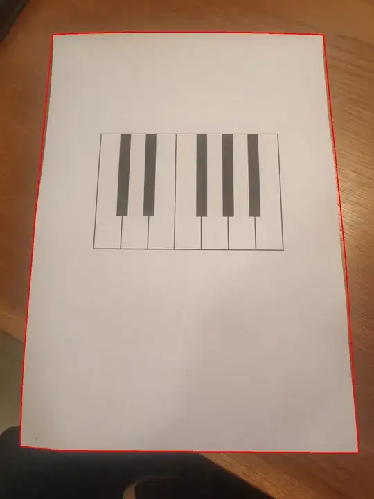

# (Optional) Draw the hull:
color = (0, 0, 255)
cv2.polylines(inputImageCopy, [hull], True, color, 2)
You'll notice I've prepared beforehand a list (cornerList) in which I'll store (hopefully) all the corners. The last two lines of the previous snippet are optional, they draw the convex hull via cv2.polylines, this would be the resulting image:
