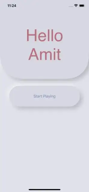

I am making a SwiftUI app and am giving it that "neomorphic" design but my issue is that since I use absolute positioning (due to the fact that I couldn't find any other viable solution), the app looks good on the iPhone 12 Pro and looks terrible on the other phones/tablets. I tried using Spacer() but I couldn't seem to understand on how to make the top "banner" into the size I want.
My code

Picture of App on Multiple Devices
Any help would be greatly Appreciated!
