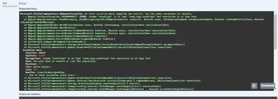

I'm writing a middleware that logs the exceptions I get.
I created enum values on postgresql
and mapped this to my log table
My Log model is:
public class Log
[Key]
[DatabaseGenerated(DatabaseGeneratedOption.Identity)]
[JsonIgnore]
public int Id { get; set; }
public EventType EventType { get; set; }
public string Description { get; set; }
public DateTime CreatedAt { get; set; }
My Error middleware is:
var log = new Log();
log.Description = ex.Message;
log.EventType = EventType.Exception;
log.CreatedAt = DateTime.Now;
Context.Add(log);
Context.SaveChanges();
(This is coming on interfaces, but I wanted to show shortly)
My Context:
protected override void OnModelCreating(ModelBuilder model)
model
.HasPostgresEnum(null, "event_type", new[] { "info", "unknown", "warning", "exception" });
protected override void OnConfiguring(DbContextOptionsBuilder optionsBuilder)
optionsBuilder
.UseNpgsql(Configuration.GetConnectionString("MyConnection"))
.UseCamelCaseNamingConvention();
NpgsqlConnection.GlobalTypeMapper.MapEnum<EventType>("enum_logs_eventType");
i think i did everything right. It is DB First, so I migrated the database, but I think you did the same steps there.
when i run the service and trigger any error i get this error:
When I try to cast to string or run .HasConversion or something i get this error:
