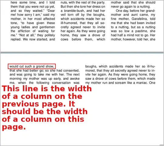

I'm using groff version 1.22.4 to create a two-page letter. The first page has three columns, the second page has 2 columns.
The macros for printing columns 1-3 on the first page work as expected. The macro for starting the second page always gives a first line that is the width of the column on the previous page.
How can I get the first line on the second page to have the correct width?
