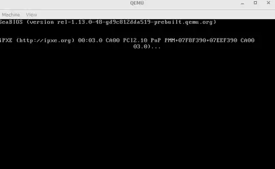

I am making an OS mostly in C++, but for the bootloader, I'm using FASM. When I try to set the GDT, Qemu clears the screen and re-prints "SeaBIOS" at the top. It continues in a loop like that until I close it. Here is a gif of it:
I tried running it with -nographic, but it does the same thing in the Windows console.
