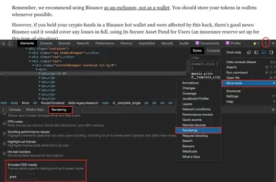

hello is there a way I could reverse the order of the rows. I have used the function data1 = data.iloc[::-1] which reverses all the values within the data table including the row numbers, however I only want it to reverse the values and leave the rows as is. So I would like row 0 : Open:242.5 , row 1 : Open:243.95 and so on. At the image below you can also see how the rows start at row#; 1862 and should be row#; 1862
