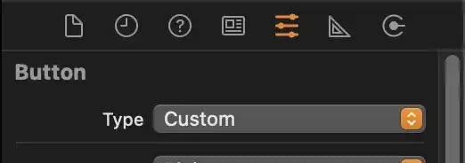

Great answer because it works well with storyboard so it avoids lots of positioning code (leaving only clean code) and I'm able to use custom images. Also nicely explained, so for a newbie to iOS like myself this is easy to implement. Now to figure out why my images appear in blue like the text on the button... – ar34z Feb 16 '15 at 08:50
Ok, to avoid your image becoming tinted blue by iOS 7+, set the property Type to Custom, as you can see in the first screenshot of @slobodans' answer, but I got the answer from here: http://stackoverflow.com/a/21313338/1479962 – ar34z Feb 16 '15 at 09:10

A simple UIButton subclass using SF symbols does the trick
class CheckBoxButton: UIButton {
override init(frame: CGRect) {
super.init(frame: frame)
setup()
required init?(coder: NSCoder) {
super.init(coder: coder)
setup()
func setup() {
setImage(UIImage(systemName: "square.fill"), for: .normal)
setImage(UIImage(systemName: "checkmark.square.fill"), for: .selected)
Storyboard
If you are using storyboard, ensure button type is set to custom as seen in the image below
Usage
All you have to do is toggle the isSelected variable in action/selector method
@objc func toggle(_ sender: UIButton) {
sender.isSelected.toggle()
Demo
