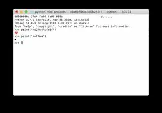

Neither of the two unicodes worked for me - they both printed black hearts. The red heart requires combining the two unicodes:
print("\u2764\uFE0F")
Explanation for why it requires two unicodes can be found here.
>>> print("\u2764\ufe0f")
Whether it "works" depends on the font you have and which glyphs it supports. Here's the same character in a non-code font (literally copy/pasted from the above):
In some more detail, U+2764 is HEAVY BLACK HEART and typically renders as a black heart: ❤
U+FE0F is VARIATION SELECTOR 16 which is a combining character which modifies the previous character, in this case to turn the heart red.
Neither of these code points has more than four hex digits so using the long-hand \U00000000 form is unnecessary.
(For what it's worth, in the text above, I see a black heart in the code font, and a red one in the regular body text font. In the MacOS Terminal, the red heart renders in a different font, so there I see it as a red heart in the Python REPL, too.)
