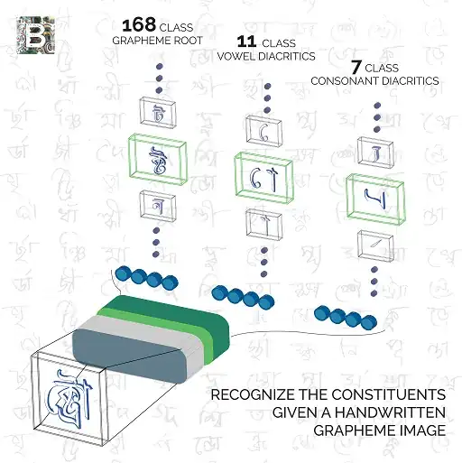

Data Set and Goal
I'm using data from here; It's a Bengali handwritten character recognition challenge, each of the samples has 3 mutually related output along with multiple classes of each. Please see the figure below:
In the above figure, as you can see, the ক্ট্রো is consist of 3 component (ক্ট , ো , ্র), namely Grapheme Root, Vowel Diactrics and Consonant Diacritics respectively and together they're called Grapheme. Again the Grapheme Root also has 168 different categories and also same as others (11 and 7). The added complexity results in ~13,000 different grapheme variations (compared to English’s 250 graphemic units).
The goal is to classify the Components of the Grapheme in each image.
