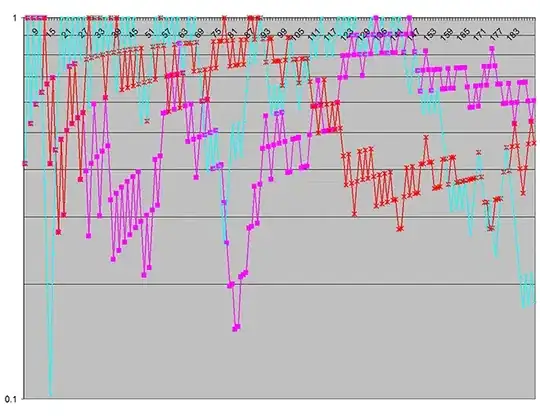

The following examples creates a plot with random point positions in xrange[0:1] and yrange[0:1] and random points size (from 2 to 6) and random transparency (from 0x00 to 0xff). The color is determined by x according to your "manual palette". I hope you can adapt this example to your needs.

Result:
