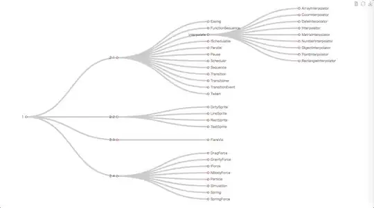

The problem
I'm creating a tree diagram using Echarts.

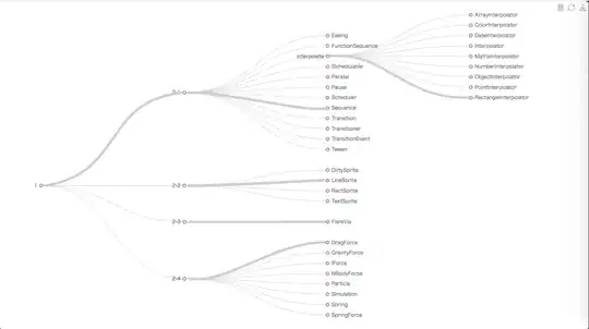

I want to change the weight of the line according to the value of data.
Expected image:
Image is for illustration purposes.
It would be helpful if you could give me advice.
The code
This is my Javascript configuration using ECharts editor page :

However, all the lines become thick as shown below.
Actual image:
