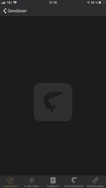

On iOS 13 Beta 5, I currently have problems with my UISplitView on iPhones.
My app starts with the detailsview off my splitview not with my masterview (look at the picture)
Does anyone know how i can fixed this problem under iOS 13? On iOS 12 everything works like a charm ☹️

my Class looks like this:
class MyClass : UITableViewController, UISplitViewControllerDelegate, UIPickerViewDelegate {
override func viewDidLoad() {
super.viewDidLoad()
if (UIDevice.current.userInterfaceIdiom == .pad){
navigationController?.navigationBar.isTranslucent = false
/*SplitView*/
splitViewController?.preferredDisplayMode = .allVisible
splitViewController?.delegate = self
self.definesPresentationContext = true
// SplitView
func splitViewController(_ splitViewController: UISplitViewController, collapseSecondary secondaryViewController: UIViewController, onto primaryViewController: UIViewController) -> Bool {
return true
I think it's look like the normal procedure for this problem :/
