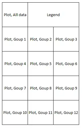

I want to be relatively free in positioning the actual elements I want to plot in a grid. For example, I want to save a page containing 13 such plots and a legend in a 5 x 3 grid - as can be seen in the example. That's why I think going with plot_grid() works better compared to, e.g., par(mfrow = c(5,3)). Additionally, using par() I get "Error in plot.new() : figure margins too large".
