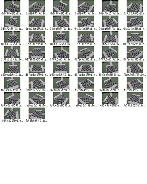

I have a setup of 4 camera's, each of which needs to be calibrated. I have 11 pictures of the charuco board 7x7_1000 for each camera, so 44 images in total
these are the raw images (for all camera's):
From what I understood in the tutorial* not all the markers need to be visible for the charuco camera calibration to work (which is the whole idea of the charuco bord) So as far as I can tell, the source images are fine.

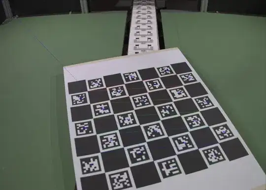

I retrieve the markers and the interpolated chessboard corners for the set of images for each camera, and feed these to the v2.aruco.calibrateCameraCharuco function. Everything seems fine, as this image with all but one marker shows:

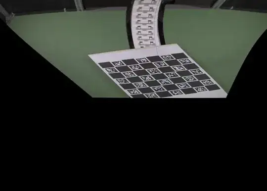

So then I go on to call the cv2.undistort function, but the result is not what I expect:
