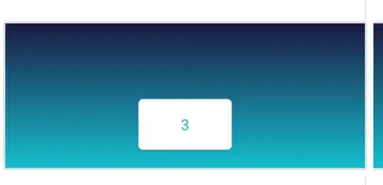

All work excellent if one cell take whole width of the screen otherwise(if each cell take 95% of screen width) every auto swipe place the cell at the beginner of screen (right side) and it is logical. So at the end of one visible cell it is start of another cell
it is doesn't looks good. I need this cell to be at the middle of the screen like this.
I need to see previous cell - current - next one
