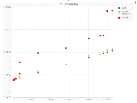

...okay, now that I look a little more deeply into the logs it just takes a lot longer for some to be scanned. When I do a batch of 16 files, with Lambda concurrency restricted to 7 the first 7 files are scanned within a few seconds. The next file begins scanning soon after, gets to "Chunks complete" within a second, but takes 23 seconds before "Scanthread: connection shutdown". From here on it just gets worse - 1:24, 1:45... and then the 3rd batch of 7 files take over 3 minutes to scan.
If I give the system a few minutes to settle down, all the threads to die off, the same files that took over 3 minutes now take about 5-7 seconds.
If I run the same test on a faster machine the performance improves, but the issue is still there:
