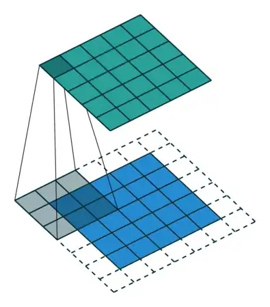

As taken from Wikipedia. This means we are looking for all pixels in your input that affect the current output. Logically, if you perform a convolution -say for example with a single 3x3 filter kernel - the receptive field of a single pixel is the corresponding 3x3 image region in the input area that gets convolved in that specific step.
Visually, in this graphic the underlying darker area marks the receptive field for specific pixels in the output:

The answer should be "obviously not". Essentially, you are still looking at the same area in the input area, although now you have a higher resolution, and similar pixels might in fact look at the same area. To get back to the GIF above: If you had 4x the number of pixels in the green area, every pixel still would have to look at a particular input region in the blue area that does not change in size. So no, upscaling does not affect this.
