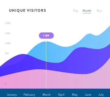

You have performance problems drawing a simple graph while "modern applications" have no problem rendering thousands of points, so why is that? A game can render more than 60 frames per second in 4K resolution and you can not render a single frame of dummy graphics to a surface.
How do they do that? Well, they cheat optimize.
If you draw not every point, but only meaningful points and fill the rest by curving like @yves-daoust suggested, you will save on some drawing time. This is like how MP3 compresses audio, it simply removes the parts you most likely be unable to hear.
