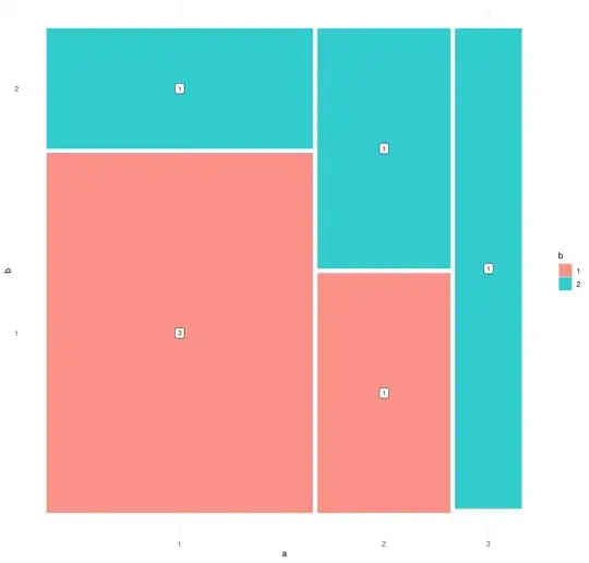

I would like to make a mosaic plot using the ggmosaic package and add the counts as shown in the example below.
The example sort of works, but I find the structure of the code quite ugly. Do you have any suggestions on how I can improve the code, to make it more reusable?
Especially the need for storing an early version of the plot in a temporary variable seems wrong compared to what usually can be achieved using ggplot2.

p <- ggplot(data) +
geom_mosaic(aes(x=product(b, a), fill=as.factor(b)))
p +
geom_label(data = ggplot_build(p)$data %>% as.data.frame() %>% filter(.wt > 0),
aes(x = (xmin + xmax)/2,
y = (ymin + ymax)/2,
label = .wt))
Created on 2018-05-08 by the reprex package (v0.2.0).
