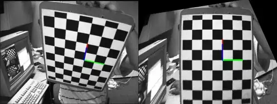

warped_img =cv2.warpPerspective(img,homography,(img.shape[1],img.shape[0]))
# where img is the above undistored image with visualized pose
The resulting warped image is not correct.
If I remove the translation from the homography by using the below code
homography = Hr.copy()
I am getting the following image
I think the above image shows that my rotational part is correct but my translation is wrong.

UPDATE:
homography = np.matmul(Ht,Hr)
warped_img =cv2.warpPerspective(img,homography,(img.shape[1],img.shape[0]),flags=cv2.WARP_INVERSE_MAP)
cv2.WARP_INVERSE_MAP flag gave me a different result
Still not the result I am looking for!
