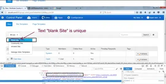

I am searching it from 2 days but still unable to get satisfying answer..please help I am using liferay, i want to open dropdown which name is "Add" and then want to click on submit button named as "Blank Site"..and both "Add" and "Blank site" button contains dynamic values/id which changes each time..attaching image for reference..

Use Xpath Contains Method:
Based on your 2 attached image, I think the button's text you are looking for is unique in the entire web page.
What you can do to fix the problem:
- For the second circumstance(
Blank Site):- Xpath:
//li/a/span[contains(text(), "Blank Site")]
- Xpath:
Suggestions:
Thanks man..it works..i have applied the same structure with "Add" button as well and both works...thank allot :) – MMaggy Nov 14 '17 at 08:51
Brother is there any way to consider 2nd text..i have two same words in a page but i want selenium to consider 2nd one only to click.. – MMaggy Nov 14 '17 at 22:10
You can append `[index]` to the end of xpath string, like `//li/a/span[contains(text(), "Blank Site")][1]`. If you want to select the last element, you can use xpath in this way`//element[@name='D'])[last()]`, you can even select the penultimate element like this`//element[@name='D'])[last()-1]`. – Nov 15 '17 at 04:53
