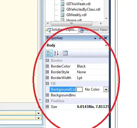

The above code snippet ended up placing the dot in the correct position, but it also started affecting the position and size of the plus button and it ended up looking like this:
But what I really want is to have the plus button in the centre of the ImageButton and the plus icon just below it. Does anyone have an idea where I'm going wrong and how can I position the two drawables correctly?
