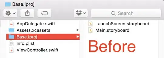

To completely disable this warning in a particular storyboard, you need to let Xcode know that the storyboard should not be considered localizable. The easiest way I was able to do this was to simply move the storyboard file from the Base.lproj folder up one level and re-add the file to the project. Once I did that, the warnings went away.
Steps
This process should work with old and new projects. Tested on Xcode 9.1 using a project created with Xcode 9.1
- Move the storyboard from the
Base.lproj folder up one level via Finder
- Delete the storyboard reference from your project via Xcode
- Drag and drop (or otherwise re-add) the storyboard to your project
- Verify using the File Inspector that the storyboard no longer has base localization
Pictorial Walkthrough
Xcode defaults to having storyboards "prepared" for localization
Move your storyboard files out of the Base.lproj folder to prevent the warnings
