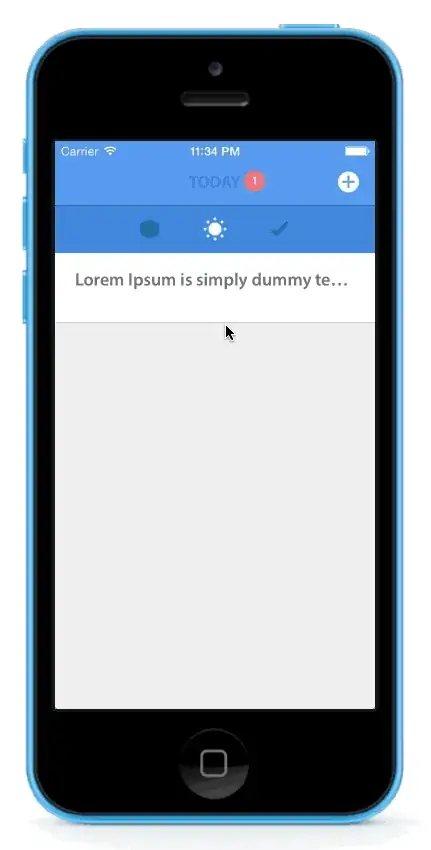

There's a behavior in the Line messenger app (the de facto messenger app in Japan) that I'm trying to emulate.
Basically, they have a modal view controller with a scroll view inside. When the scroll action reaches the top of its content, the view controller seamlessly switches to an interactive dismissal animation. Also, when the gesture returns the view to the top of the screen, control is returned to the scroll view.
Here's a gif of how it looks.
For the life of me, I can't figure out how they did it. I've tried a few different methods, but they've all failed, and I'm out of ideas. Can anyone point me in the right direction?

To clarify, the behavior that I want to emulate isn't just simply dragging the window down. I can do that, no problem.
I want to know how the same scroll gesture (without lifting the finger) triggers the dismissal transition and then transfers control back to the scroll view after the view has been dragged back to the original position.
This is the part that I can't figure out.
