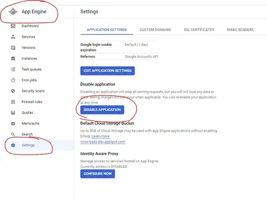

With the new Google Cloud console, you can still disable GAE applications as before (App Engine --> Settings --> Disable). They cannot currently be deleted.

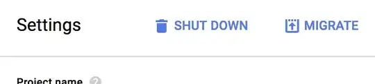

If you are sure that you aren't using the project for anything else, you can delete the entire project by going to IAM --> Settings --> Shut Down. This button is in the header and a bit tricky to spot. It looks like this:

However, it all depends on why you would like to delete your app. If you would simply like to stop it from serving requests or you don't want it to incur further costs, you can disable the app as described in the GCP docs here.

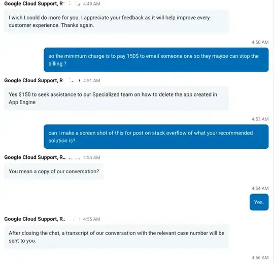

I was evaluating if we could use AppEngine and ran the standard tutorial which created a test app for me under my the default project. When I tried to delete the App I was shocked that it can't be done ! The only way is to delete the project which would delete all other GKE and any other services under that account.
After a bunch of research and calling product support of Google this what they suggested: To upgrade to Silver Support for 150$/month and send them an email to delete the app.
Here is the chat session with Google Support. If you were considering using Google AppEngine I would think again.

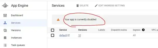

Beyond disabling the App Engine application you can:
APIs & ServicesStorageIAM & AdminService account This will freeze all App Engine related billing charges for the undeletable disabled App engine application. At least it worked for me :)

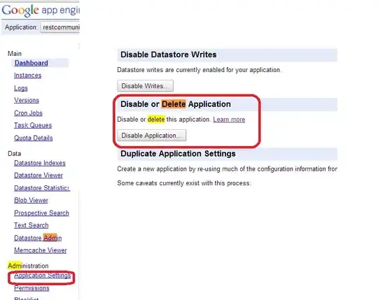

This issue has been fixed; see the docs here: https://cloud.google.com/appengine/docs/standard/python/console/?csw=1#delete_app
Carlos, you're right that the issue has been fixed, and I up-voted you for that. However, your link is a little outdated and an updated link is listed below. https://developers.google.com/appengine/docs/adminconsole/applicationsettings#Disable_or_Delete_Your_Application

I couldn't find to delete the default app-engine, however if you navigate to App Engine > Settings , there is a button to Disable it and it stop serving. when you click on the button type the project name in the prompt.
