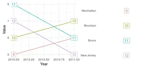

Then, use plot_grid to stitch everything together. The simplest version has no arguments, but doesn't look great:
plot_grid(plotPart, legendPart)
gives
But, we can control the spacing with rel_widths (you will need to play with it to fit your actual data and aspect ratio):
plot_grid(plotPart
, legendPart
, rel_widths = c(0.9, 0.2)
gives
I personally like to "squish" the legend a bit, so I usually nest the legend within another plot_grid call, here including a title for good measure:
plot_grid(
plotPart
, plot_grid(
ggdraw()
, ggdraw() + draw_label("Legend")
, legendPart
, ggdraw()
, rel_heights = c(1,1,3,2)
, ncol = 1
gives
Which I believe meets the requirements from your question, though you will still likely want to tweak it to match your prefered style, etc.
