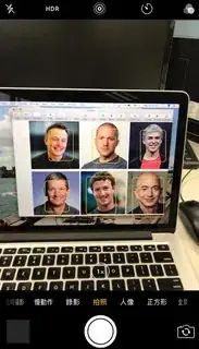

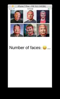

The findFace works with normal image. However, the image I capture via camera will not work or sometimes only recognize one face.
Normal Image
Capture Image
