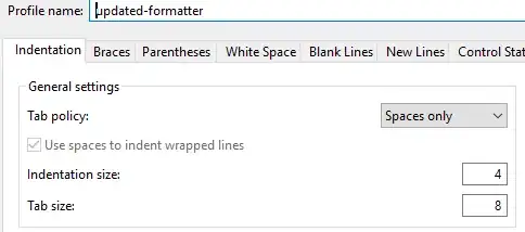

- Under General Settings, set Tab policy to:
Spaces only - Click OK ad nauseam to apply the changes.

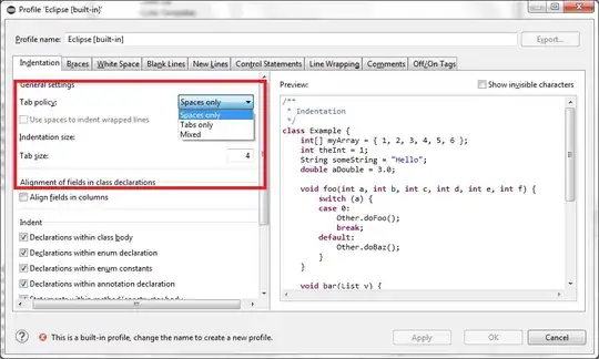

Go to Window -> Preferences and type tab as the search text (which will display a dialog like below):
Go to the highlighted sections to change the tab policy. For the Editor settings it is mostly Indent using spaces (also shown above).
For Formatter settings you need to edit the active profile and update Tab policy (available under `Indentation -> General settings:

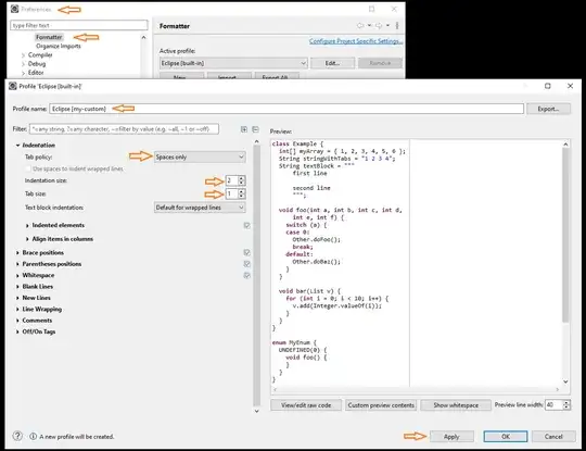

In Eclipse go to Window » Preferences then search for Formatter.
You will see various bold links,
click on each bold link
and set it to use spaces instead of tabs.
In the java formatter link, you have to edit the profile
and select the tab policy, spaces only in indentation tab

- Click Window » Preferences
- Expand Java » Code Style
- Click Formatter
- click new
- Select the profile name
- Click ok
- Click the Edit button
- Click the Indentation tab
- Under General Settings, set Tab policy to: Spaces only
- Click OK.

As an augmentation to the other answers, on Mac OS X, the "Preferences" menu is under Eclipse, not Window (unlike Windows/Linux Eclipse distributions). Everything else is still the same as pointed out by other answers past this point.
IE: Java Formatter available under:
Eclipse > | # Not Window!
Preferences > |
Java > |
Code Style > |
Formatter |
From here, edit the formatter and the tab policy can be set under "Indentation".
