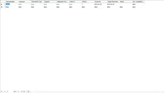

When I set the datasource to dsA, I get this output. Notice both the GENERATEDKEY and the ROWID values.
When I set the datasource to dsB, I get this output, with no GENERATEDKEY and no ROWID.
As far as I can tell, both Oracle schemas are set up the same way, and both datasources are configured identically. Does anyone have any idea what could cause one query to return the GENERATEDKEY and the other not to? I'm pulling my hair out trying to find a cause for this.
