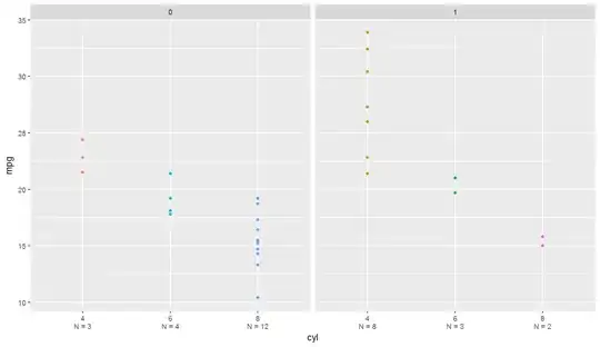

However, this function does not work correctly with faceting. For example:
ggstripchart(mtcars, "cyl", "mpg") + facet_wrap(~am)
shows the the sample sizes for both facets combined for each facet. I would have to build faceting into the wrapper function, which defeats the point of trying to use everything ggplot has to offer.
