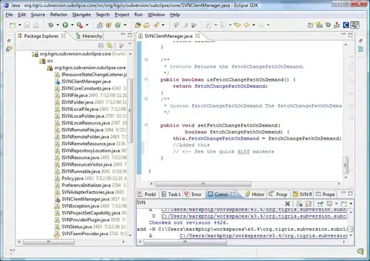

Results in the following (code in picture is slightly different as I adjusted the pasted code here for cleanliness and to make it easier for you to reproduce the problem using the table data in the pastebin link below.)
