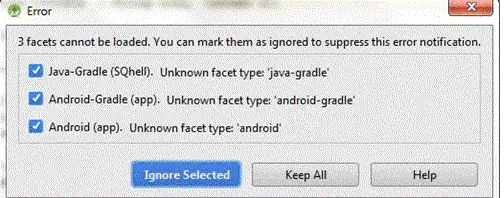

I was using Android Studio 3.0.1 and Gradle 4.1 when I got the "Facets" errors. I fixed it by doing what follows.
Stop AS. If AS is hung, force it to stop using Task Manager.
Restart AS. if you have errors and NO WAY TO GET TO FILE>SETTINGS…, you likely are where I was. Read on.
If you have a popup about facets that is similar to this...
... look at Gradle console. If you get the message Problems found loading plugins, followed by a list of errors that say “required plugin Android Support is disabled " , followed by a message that has a link saying " ...( show balloon)`, click that link.
The link will have an option to Choose to enable Android Support `. Do so.
Restart AS.
