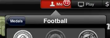

However, when rapid navigational clicks occur, for some reason it unchecked, and the user is logged out. How come?
This is the button I press rapidly. NOTE: It also changes the page from www.example.com to www.example.com/users, and then just repeats www.example.com/users until session is broken.
And this is the result after about, 2-3 rapid clicks. Works fine when pressed 1-2 times a second, max.
