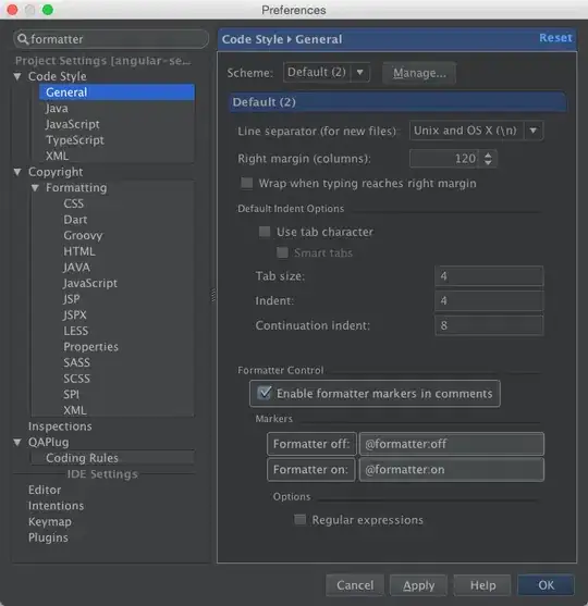

Ensure formatter markers in comments are enabled, as shown in the following figure:

107You must go to `Preferences`->`Code Style`->`General`->`Formatter Control` and check `Enable formatter markers in comments` for this to work. – Heath Borders Aug 27 '14 at 21:06

Note for Carlos' answer of @formatter:off and @formatter:on to work, you may need to enable the preference first:
