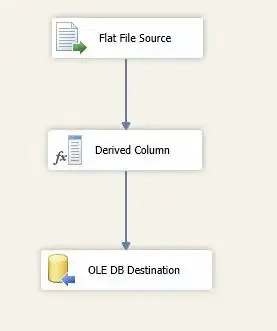

The SSIS package (see below) is moving BIRTHDATE column from one staging table into another. Starting from scratch Flat File Source to Staging table:
Derived Column for the DATE (vachar) column:
(DT_STR,40,1252)((TRIM(BDAY) == "" ? 0 : 1) == 0 ? ((DT_STR,40,1252)"19000101") : ((DT_STR,40,1252)(SUBSTRING((REPLACE(BDAY,"/","")),5,4) + SUBSTRING((REPLACE(BDAY,"/","")),3,2) + SUBSTRING((REPLACE(BDAY,"/","")),1,2))))
