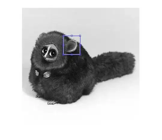

With that, I get the following image:
I also get the following when showing a surface plot of the cross power spectrum:
There is a clear defined peak where the rest of the output has a very small response. That's actually a property of Phase Correlation and so obviously, the location of the maximum value is clearly defined and this is where the template is located.
