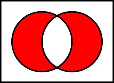

Looking for the easist/most scalable way to do a set "difference" in SQL Server see below.
If you can't tell from the picture i am looking for everything that is not in the intersection.
