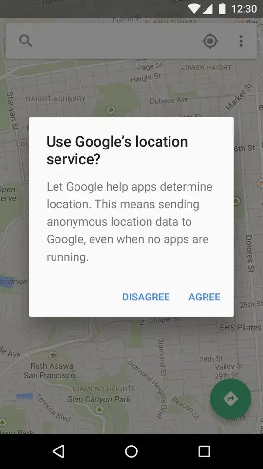

I've been searching for an easy and clean way to change my AlertDialog side margin but with no success. Just to be extra clear, what I want is to change the distance between each of sides of the dialog and the side/edge of the screen. I would like my dialogs to show up similar to those that appears in the
Material Design specification
Here's an image of what I would like/expect from a simple android AlertDialog, and on the right, what I'm actually seeing with the code below.
Here's my code.
