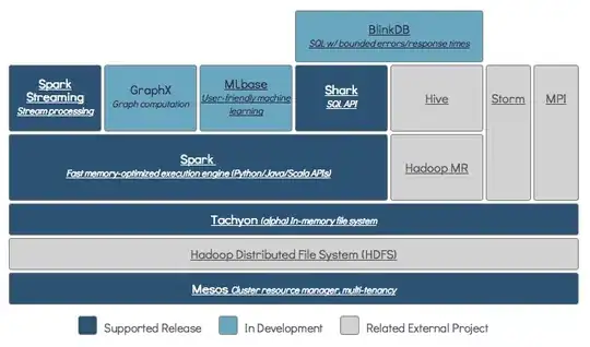

Additionally, if you use Tachyon, it will boost performance with Hadoop. It's highly recommended to use Hadoop for Apache Spark processing.
